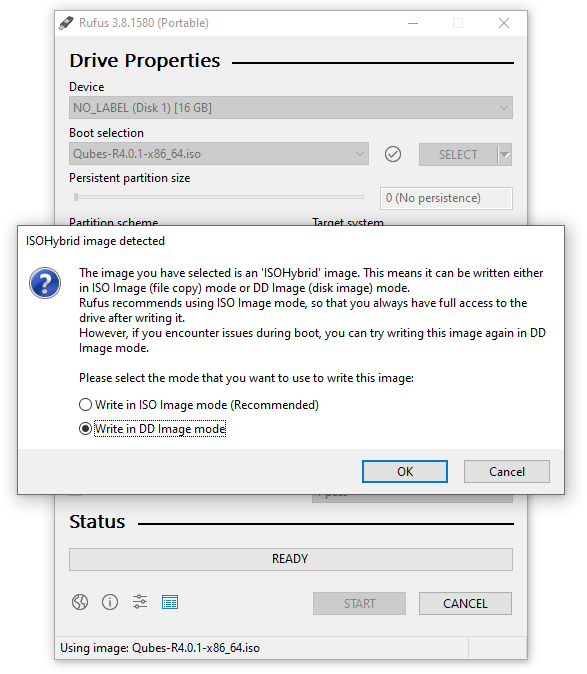

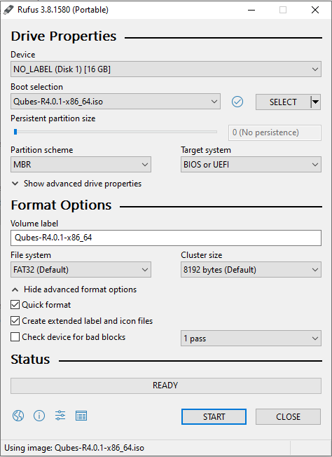

On Windows, you can use the Rufus tool to write the ISO to a USB key. Be sure to select “Write in DD Image mode” after selecting the Qubes ISO and pressing “START” on the Rufus main window.
Note
Note: Using Rufus to create the installation medium means that you won’t be able to choose the “Test this media and install Qubes OS” option mentioned in the example below. Instead, choose the “Install Qubes OS” option.

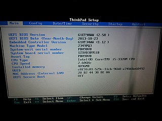

Here’s an example of what the BIOS menu looks like on a ThinkPad T430:

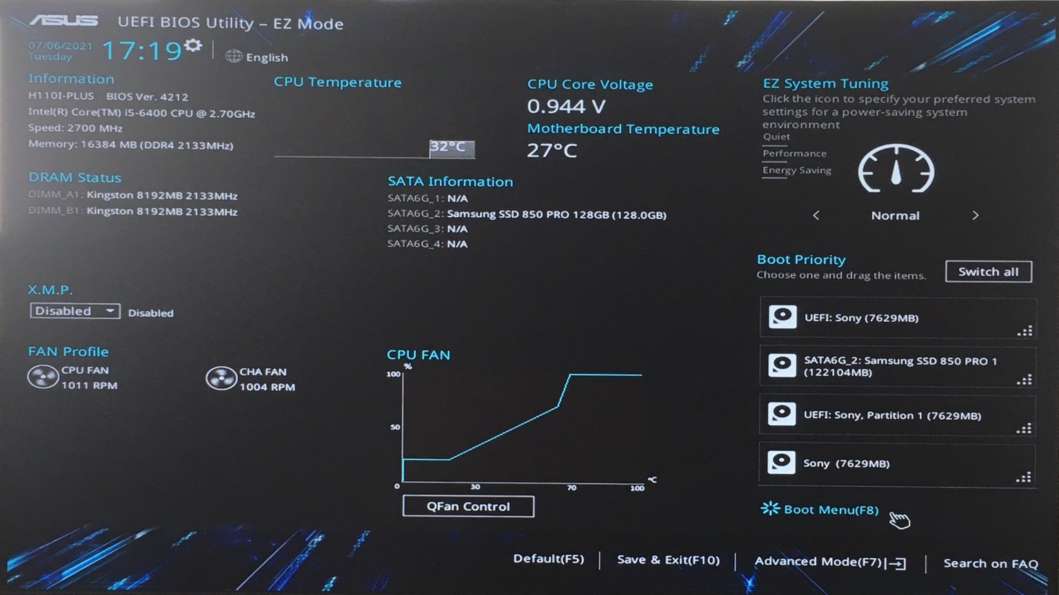

And here’s an example of what a modern UEFI menu looks like:

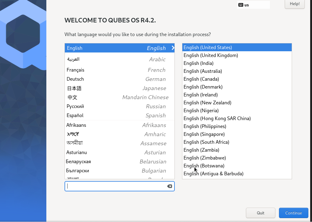

On the first screen, you are asked to select the language that will be used during the installation process. When you are done, select Continue.

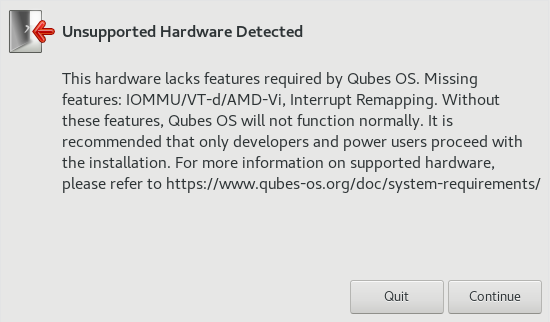

Prior to the next screen, a compatibility test runs to check whether IOMMU-virtualization is active or not. If the test fails, a window will pop up.
Do not panic. It may simply indicate that IOMMU-virtualization hasn’t been activated in the BIOS or UEFI. Return to the hardware requirements section to learn how to activate it. If the setting is not configured correctly, it means that your hardware won’t be able to leverage some Qubes security features, such as a strict isolation of the networking and USB hardware.

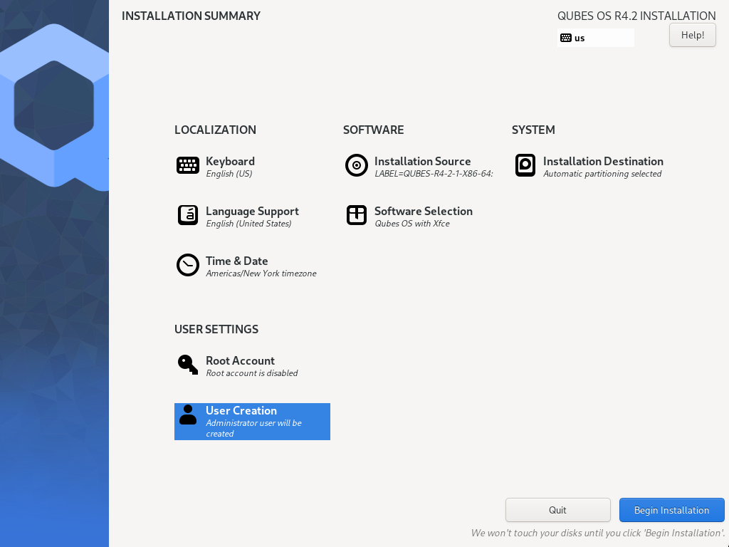

The Installation summary screen allows you to change how the system will be installed and configured, including localization settings. At minimum, you are required to select the storage device on which Qubes OS will be installed.

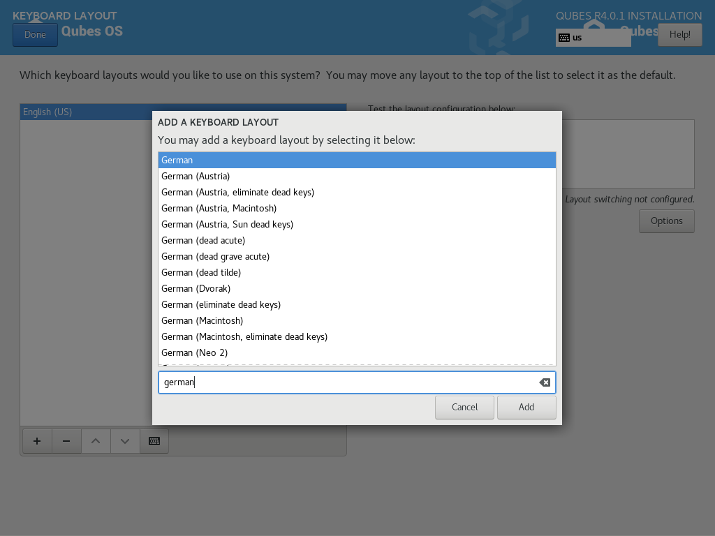

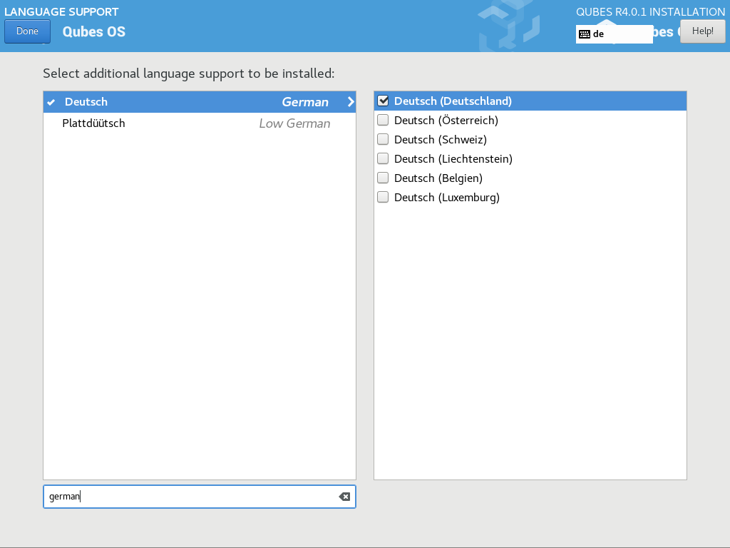

Let’s assume you wish to add a German keyboard layout. Go to Keyboard Layout, press the “Plus” symbol, search for “German” as indicated in the screenshot and press “Add”. If you want it be your default language, select the “German” entry in the list and press the arrow button. Click on “Done” in the upper left corner, and you’re ready to go!
The process to select a new language is similar to the process to select a new keyboard layout. Follow the same process in the “Language Support” entry.
You can have as many keyboard layout and languages as you want. Post-install, you will be able to switch between them and install others.

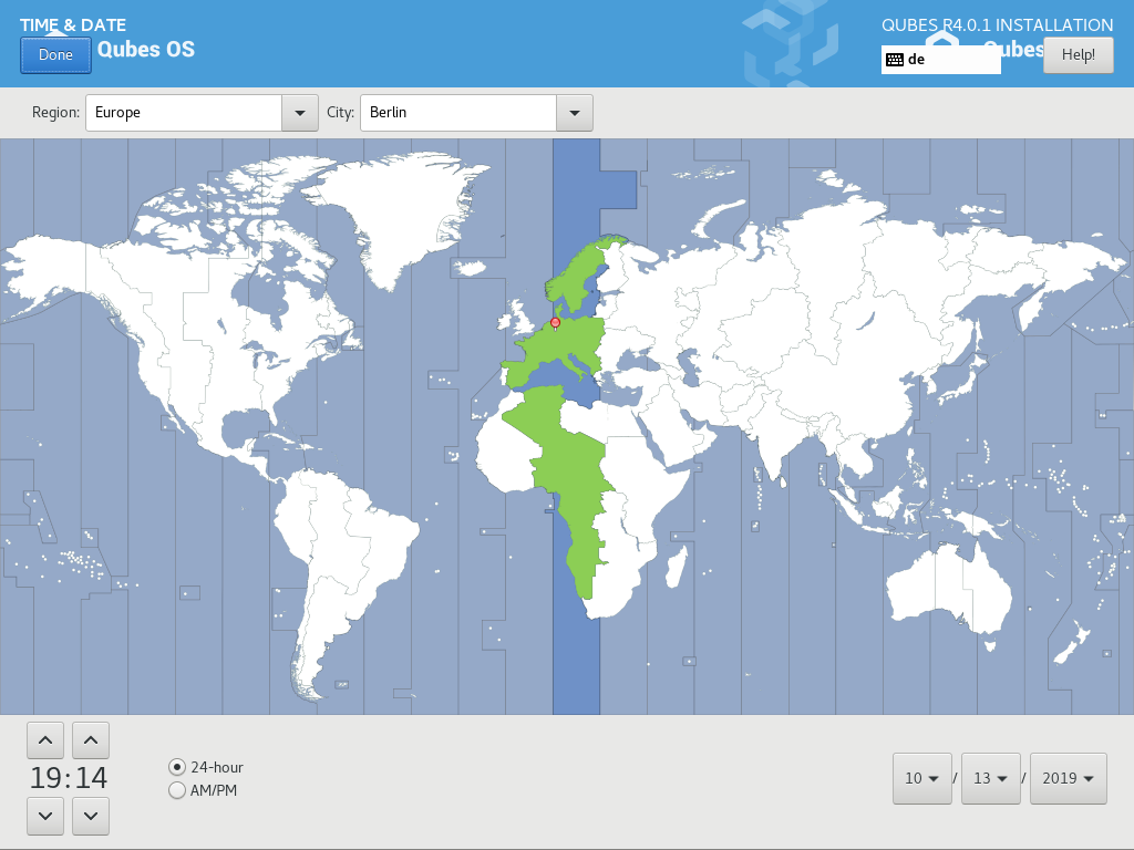

Don’t forget to select your time and date by clicking on the Time & Date entry.

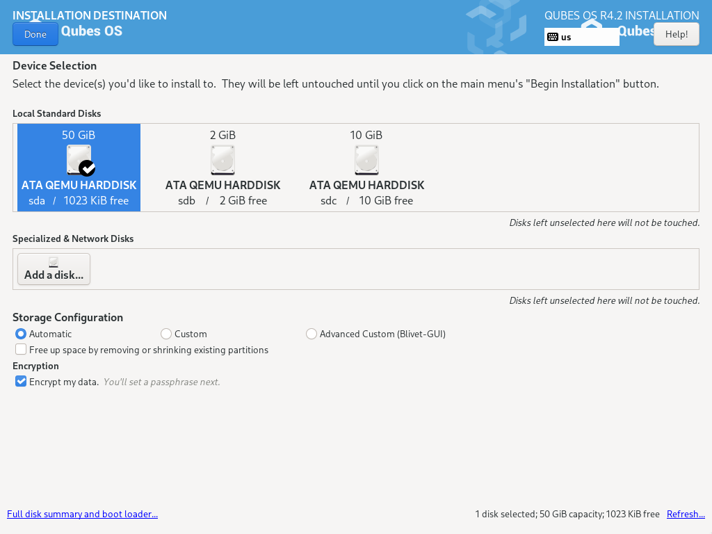

Installation destination
Under the System section, you must choose the installation destination. Select the storage device on which you would like to install Qubes OS.
Danger
Warning: Be careful to choose the correct installation target, or you may lose data. We strongly recommended making a full backup before proceeding.
Your installation destination can be an internal or external storage drive, such as an SSD, HDD, or USB drive. The installation destination must have a least 32 GiB of free space available.
Warning
Note: The installation destination cannot be the same as the installation medium. For example, if you’re installing Qubes OS from a USB drive onto a USB drive, they must be two distinct USB drives, and they must both be plugged into your computer at the same time. (Note: This may not apply to advanced users who partition their devices appropriately.)
Installing an operating system onto a USB drive can be a convenient way to try Qubes. However, USB drives are typically much slower than internal SSDs. We recommend a very fast USB 3.0 drive for decent performance. Please note that a minimum storage of 32 GiB is required. If you want to install Qubes OS onto a USB drive, just select the USB device as the target installation device. Bear in mind that the installation process is likely to take longer than it would on an internal storage device.
Note
Did you know? By default, Qubes OS uses LUKS /dm-crypt to encrypt everything except the /boot partition.

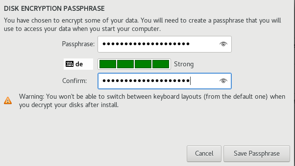

As soon as you press Done, the installer will ask you to enter a passphrase for disk encryption. The passphrase should be complex. Make sure that your keyboard layout reflects what keyboard you are actually using. When you’re finished, press Done.
Danger
Warning: If you forget your encryption passphrase, there is no way to recover it.

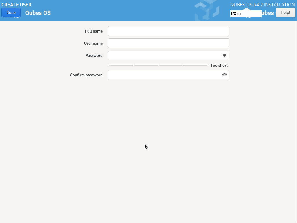

Select “User Creation” to create your user account. This is what you’ll use to log in after disk decryption and when unlocking the screen locker. This is a purely local, offline account in dom0. By design, Qubes OS is a single-user operating system, so this is just for you.
The new user you create has full administrator privileges and is protected by a password. Just as for the disk encryption, this password should be complex. The root account is deactivated and should remain as such.

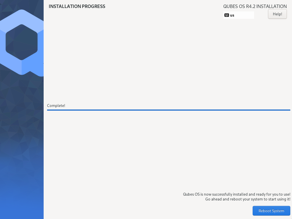

When the installation is complete, press Reboot System. Don’t forget to remove the installation medium, or else you may end up seeing the installer boot screen again.

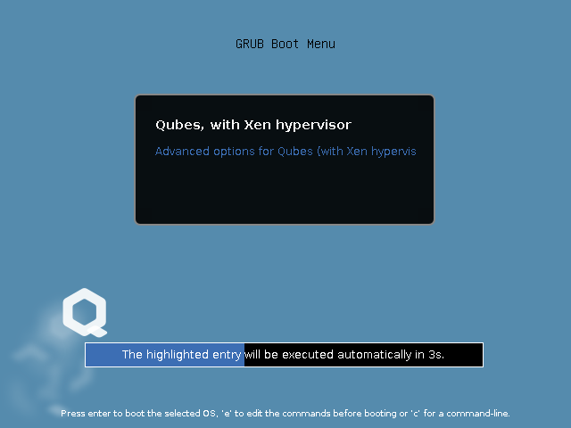

First boot

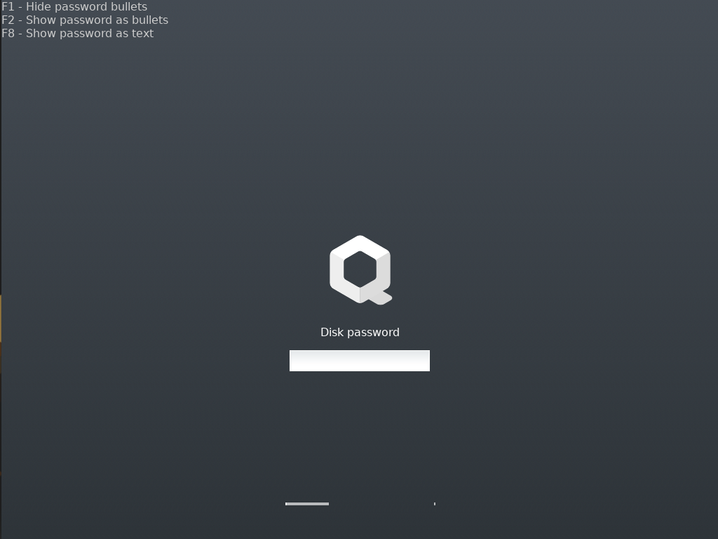

If the installation was successful, you should now see the GRUB menu during the boot process.
Just after this screen, you will be asked to enter your encryption passphrase.

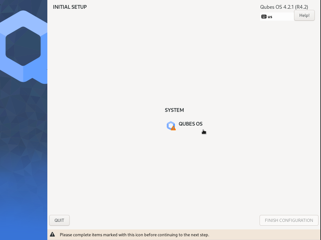

You’re almost done. Before you can start using Qubes OS, some configuration is needed.
Click on the item marked with the warning triangle to enter the configuration screen.

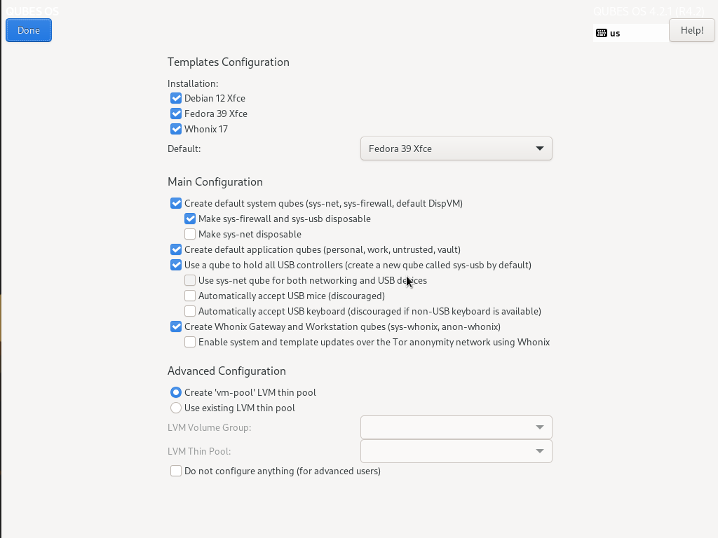

By default, the installer will create a number of qubes (depending on the options you selected during the installation process). These are designed to give you a more ready-to-use environment from the get-go.
Let’s briefly go over the options:
Templates Configuration: Here you can decide which templates you want to have installed, and which will be the default template.
Create default system qubes: These are the core components of the system, required for things like internet access. You can opt to have some created as disposables.
Create default application qubes: These are how you compartmentalize your digital life. There’s nothing special about the ones the installer creates. They’re just suggestions that apply to most people. If you decide you don’t want them, you can always delete them later, and you can always create your own.
Use a qube to hold all USB controllers: Just like the network qube for the network stack, the USB qube isolates the USB controllers.
Use sys-net qube for both networking and USB devices: You should select this option if you rely on a USB device for network access, such as a USB modem or a USB Wi-Fi adapter.
Create Whonix Gateway and Workstation qubes: If you want to use Whonix, you should select this option.
Enabling system and template updates over the Tor anonymity network using Whonix: If you select this option, then whenever you install or update software in dom0 or a template, the internet traffic will go through Tor.
Do not configure anything: This is for very advanced users only. If you select this option, you will have to manually set up everything.
When you’re satisfied with your choices, press Done. This configuration process may take a while, depending on the speed and compatibility of your system.

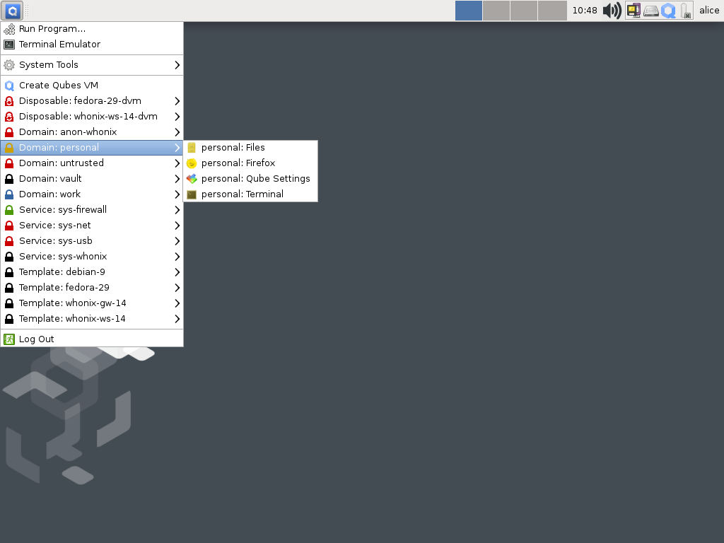

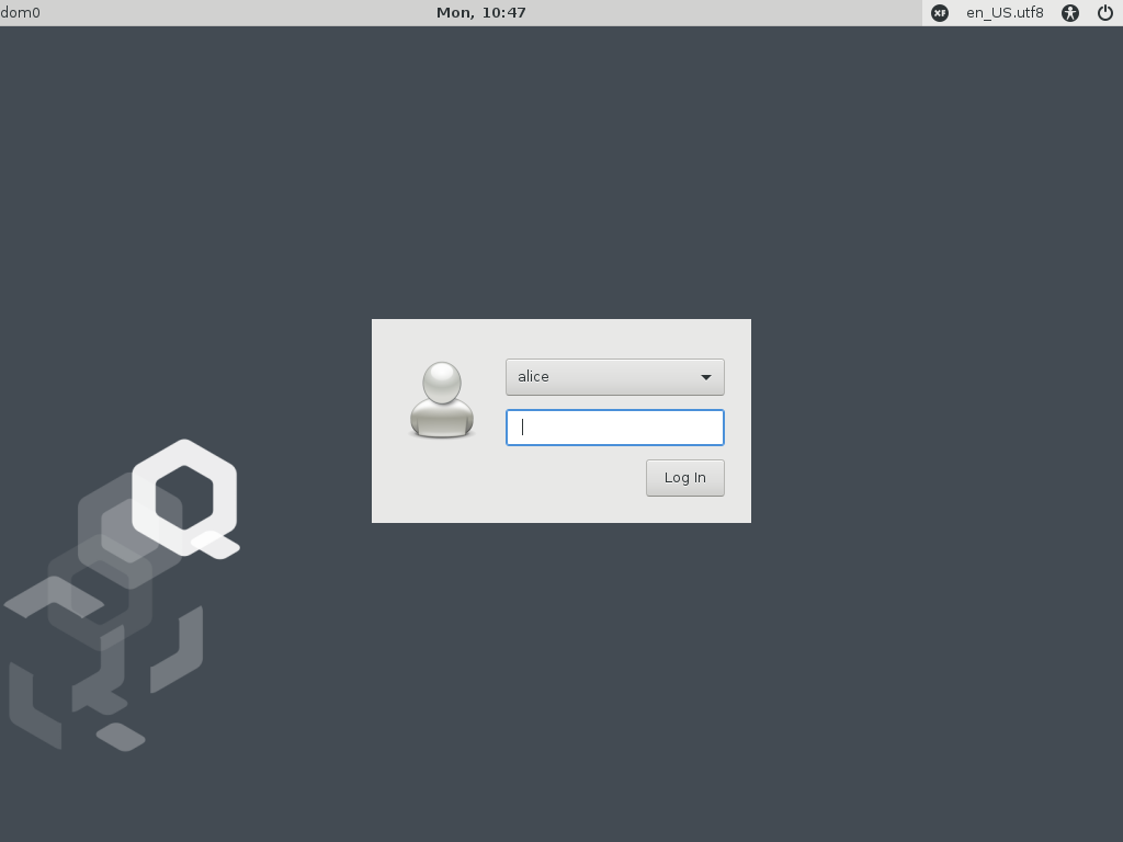

After configuration is done, you will be greeted by the login screen. Enter your password and log in.
Congratulations, you are now ready to use Qubes OS!
