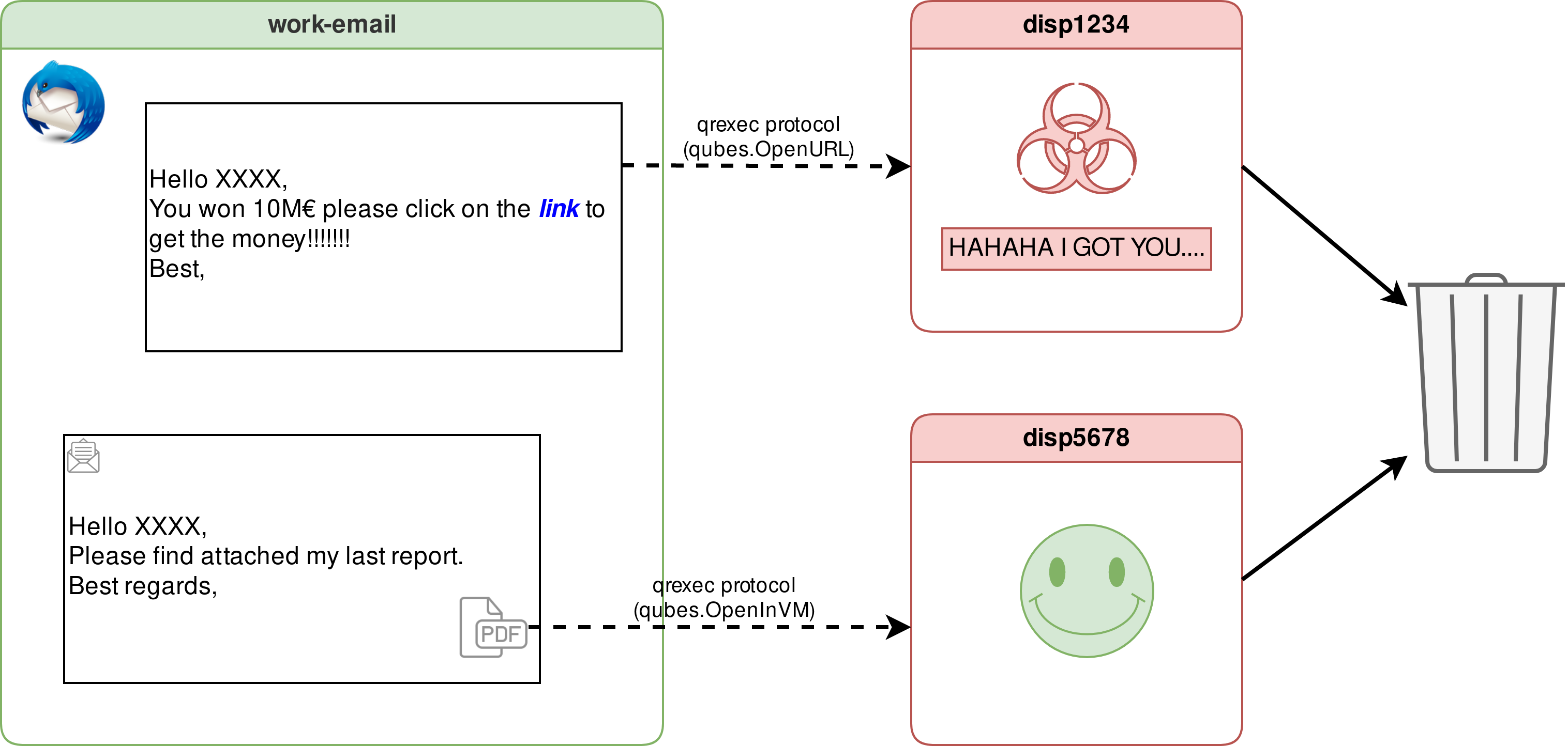

A disposable is a lightweight qube that can be created quickly and will self-destruct when closed. Disposables are usually created in order to host a single application, like a viewer, editor, or web browser.
From inside an app qube, choosing the Open in disposable option on a file will launch a disposable for just that file. Changes made to a file opened in a disposable are passed back to the originating qube. This means that you can safely work with untrusted files without risk of compromising your other qubes. Disposables can be launched either directly from dom0’s app menu or terminal window, or from within app qubes. Disposables are generated with names like disp####, where #### is random number.
This diagram provides a general example of how disposables can be used to safely open untrusted links and attachments in disposables. See this article for more on why one would want to use a disposable.

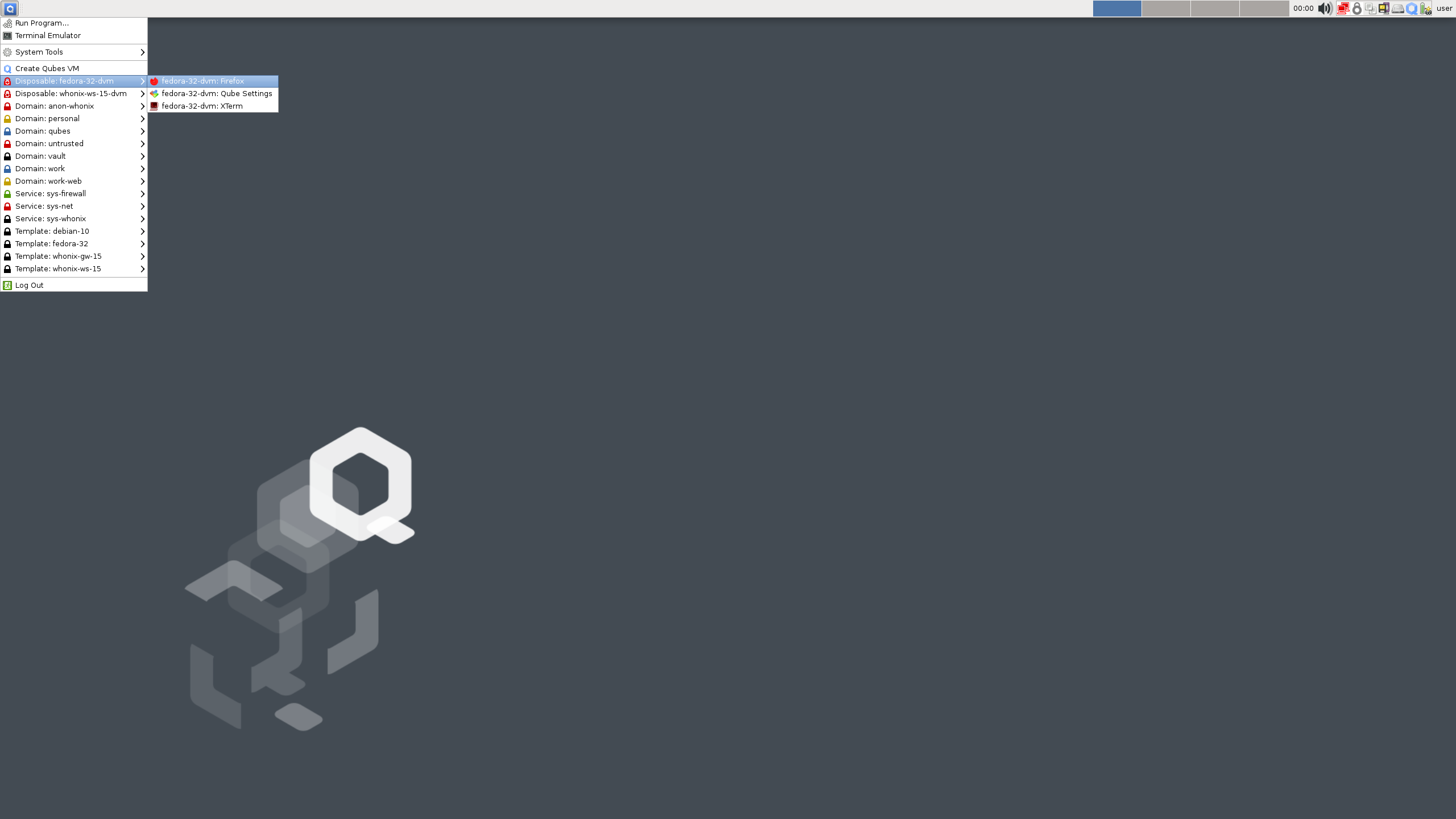

How to create disposable templates
First, you need to create an app qube. You can run it normally, set up any necessary settings (like browser settings) you wish to be applied to every disposable qube ran from this template. Next, go to ‘Qube Settings’ of the app qube, set it as a Disposable template in the Advanced section and apply the change.
In Qubes 4.1, the entry in the Application menu is split into ‘Disposable’ and ‘Template (disp)’. The settings for the disposable can be changed under
In Qubes 4.2, the qube will now appear in the menu as a disposable template (in the Apps section), from which you can launch new disposable qubes. To change the settings of the template itself or run programs in it, use the menu item for the disposable template located in the Templates section.
