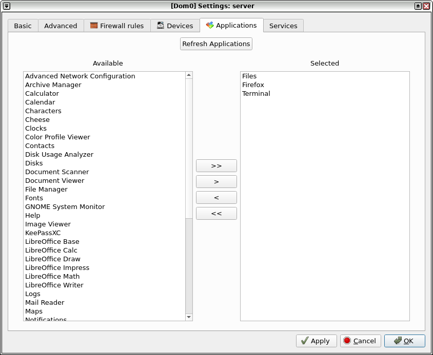

(Recommended) In the relevant qubes’ tab, select the new application(s) from the list, and press OK. These new shortcuts will appear in the Applications Menu. (If you encounter problems, see App menu shortcut troubleshooting)

Refresh the Applications list for the app qube. In the Qubes Menu for the app qube launch the Qube Settings. Then go to the Applications tab and click “Refresh Applications”
The refresh will take a few minutes; after it’s complete the Snap app will appear in the app qube’s list of available applications. At this point the snap will be persistent within the app qube and will receive updates when the app qube is running.
